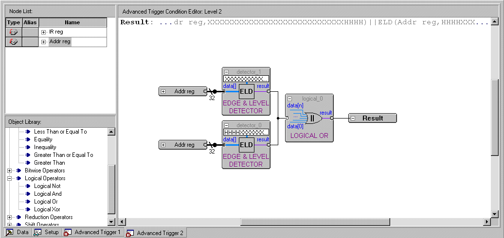

In the following example, the advanced trigger condition filters data from Addr reg when you use two Edge & Level Detector objects before passing
the filtered data through a Logical Or object. One Edge & Level Detector object detects when the 4 MSBs of the 32-bit Addr
reg register are high, while the other Edge & Level Detector object detects when the 4 LSBs of the 32-bit Addr reg register are high. The
advanced trigger condition uses the Logical Or object to trigger when one of these conditions is met.
Logical Or object connected to Edge & Level Detector Example
